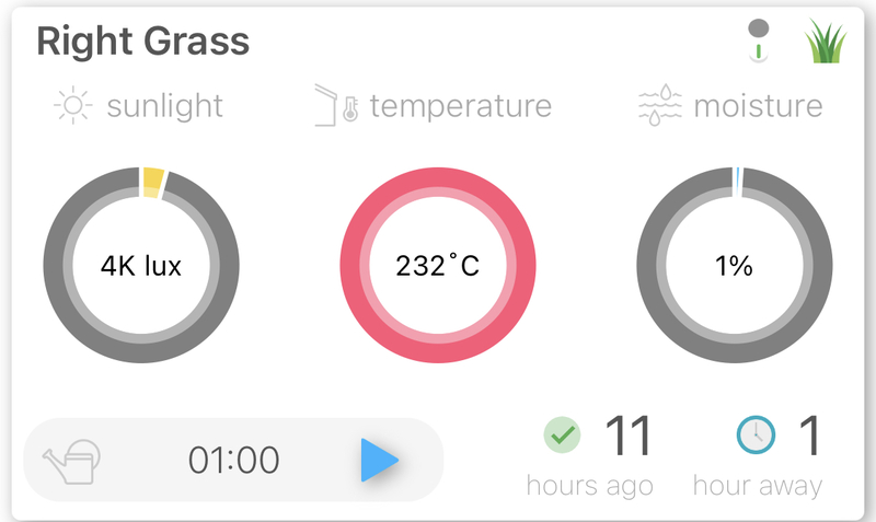

Gianluca De Virgilio
更新時間 2021-06-07 16:13:28 UTC
Good afternoon,
I have two sensors that register always the same % of humidity. One, about 4/5% and the other about 98%.
For a test, yesterday I poured direct water in the sensor that indicate 4% and it jumped imediatelly to 95%, V but after a few minutes it returned down. Also during a small raining it didn’t change. Is there some suggestion to be function them right? Position, mode of positioning into che garden ….
Gianluca

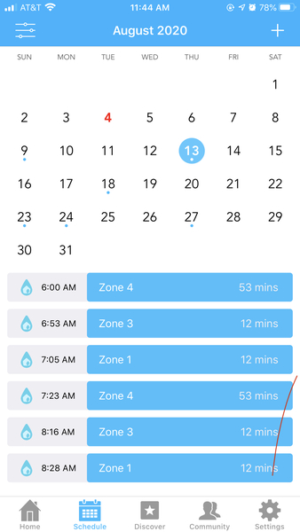

How do I do long uninterrupted watering?
Douglas Peale
更新時間 2021-05-28 02:59:54 UTC
The Sprite is breaking the watering of my trees into a whole bunch of short bits of watering. Given the way my soil sucks down water, I'd prefer to water my trees for 4 contiguous hours of watering every two weeks, but there does not seem to be a way do specify this directly.
