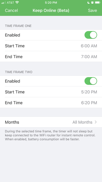

If you have to water instantly, you can go to Settings -> Timer-> "Keep Online" and enable the feature. Note the timer may start to keep online the next day and battery consumption will be faster when the timer is in this mode. Here is an example of the settings:
