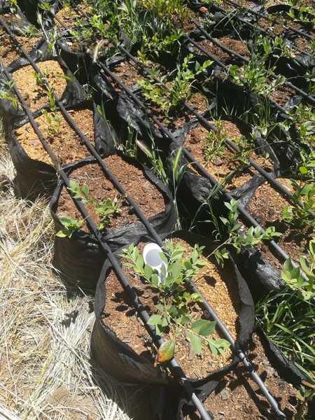

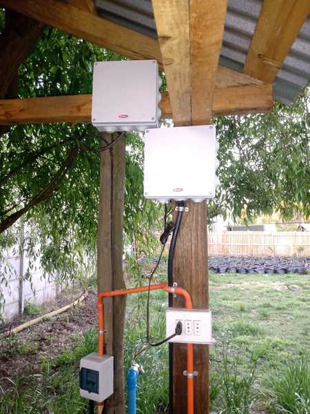

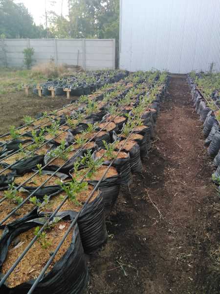

Hola les cuento mi experiencia con Netro, trabajo actualmente en el estado de Nueva York, y tengo 500 plantas de bluebery en Chile souh America, y lo controlo desde acá, he tenido excelentes resultados con el sensor de humedad, me hubiese gustado que el sensor fuera más largo, pero con el actual se ha manejado perfecto, también creo que deberían diseñar una caja más robusta para exteriores, estoy muy feliz con la aplicación con el equipo y el sensor.

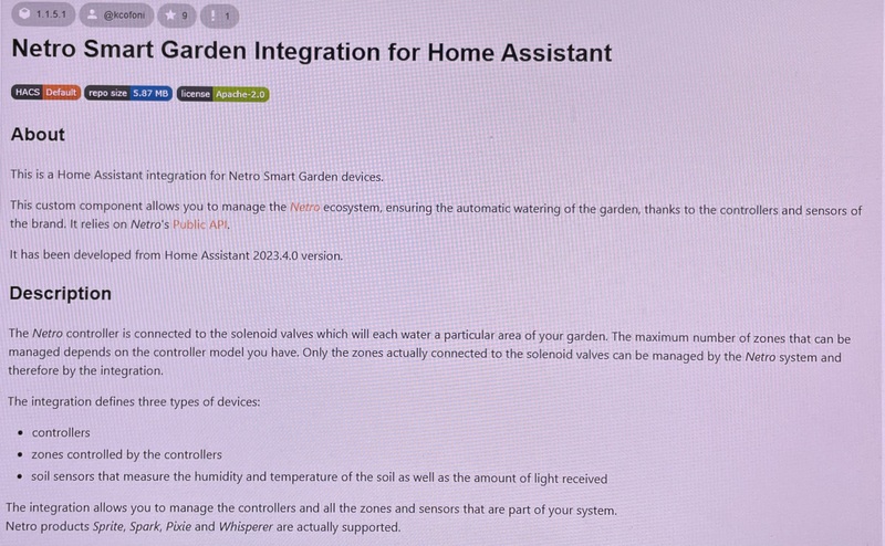

I just developed a Netro Smart Garden integration for Home Assistant.
Take a look here if interested: https://github.com/kcofoni/ha-netro-watering.
Best regards

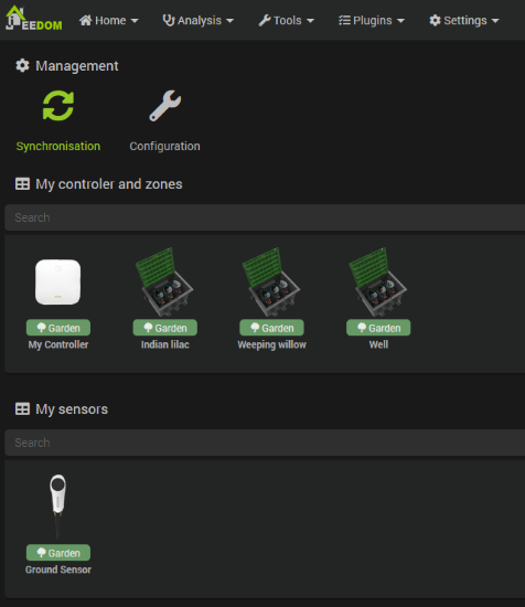

Hello guys,
Thanks to Netro public API, I have developed a plugin for Jeedom which allows us to take control of our great netro devices within this famous home automation system. if you are interested, don't hesitate to take advantage of it, it's free of charge !
Please find the documentation right here for further details : https://kcofoni.github.io/jeedom-docs/plugin-netroarrosage/docs/en_US/

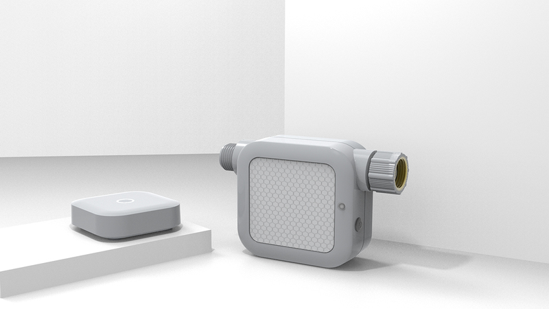

To the Netro community:
We are excited to introduce our new products, the Netro Zigbee Hub and the new smart timer Pixie-Z1. They combined deliver a different experience of smart watering system.
The Netro Zigbee Hub hosts a long-range local Zigbee network that links all the end devices. It connects to your router (wireless or wired) to transfer data between the end devices and the Netro cloud service. The Hub will work with all our Zigbee products including the new timer Pixie-Z1(introduced below) and the new soil moisture sensor coming this year, as well as the new 4-Zone sprinkler controller and the new weather sensor coming next year.
The new host timer Pixie-Z1 is re-designed from the original Pixie timer in many ways:
1. Always online for instant quick runs. No more sleep mode
2. Powered by two AA alkaline batteries with approximately one year of battery life. Notifications on low battery
3. Supports Google Home and Google Assistant
The Netro Zigbee Hub and Pixie-Z1 are expected to ship in September. To join the Tester program please email to info@netrohome.com and we will send you a discount code in return for feedbacks.
