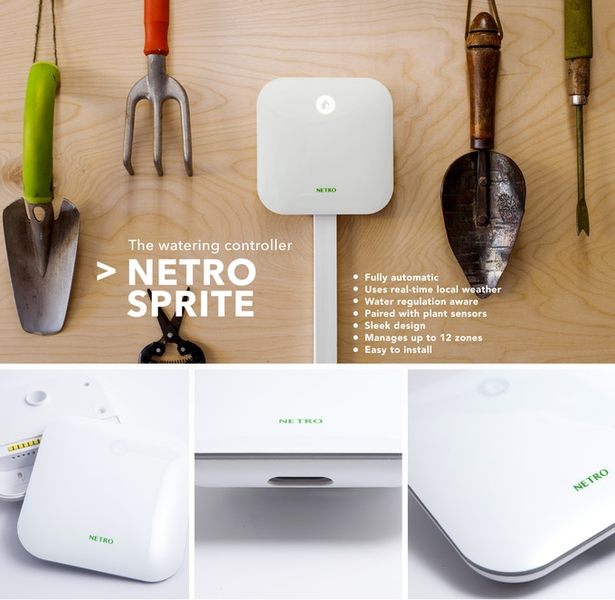

Sprite-6, with 24V power adapter (US)
Price: $29.99 / year
Model:
Power Adapter:
In Stock
Mechanical Specifications
– Dimensions: 5.7 X 5.7 X 1.2 (inches)
– Weight: 8.2 oz / 230 g
– Output: 6 zones + 1 master valve
– Wire size: 18 AWG to 22 AWG
– Operating temperature: -4 to 122℉ / -20 to 50℃
– Box contains: smart irrigation controller, AC adapter, wall screws, quick installation guide
Electrical Specifications
– AC Input: 24VAC, 50/60Hz, 800mA
– Valve output: 24VAC, 50 / 60Hz, max 10VA
– Master valve: 24VAC, 50 / 60HZ, max 10VA
– WiFi: 802.11 N, 2.4Ghz, US / Japan / EU

The Netro controller is designed for indoor use only. For outdoor use, you will need to buy the Netro outdoor enclosure to cover both the controller and the power adaptor.
Not for most cases. The Netro controller works with your existing 24V AC sprinkler system (the pumps, valves, pipes and nozzles). You just need to replace or install the controller. If you have 9V DC valves, then you will need to change them to 24V AC valves.
