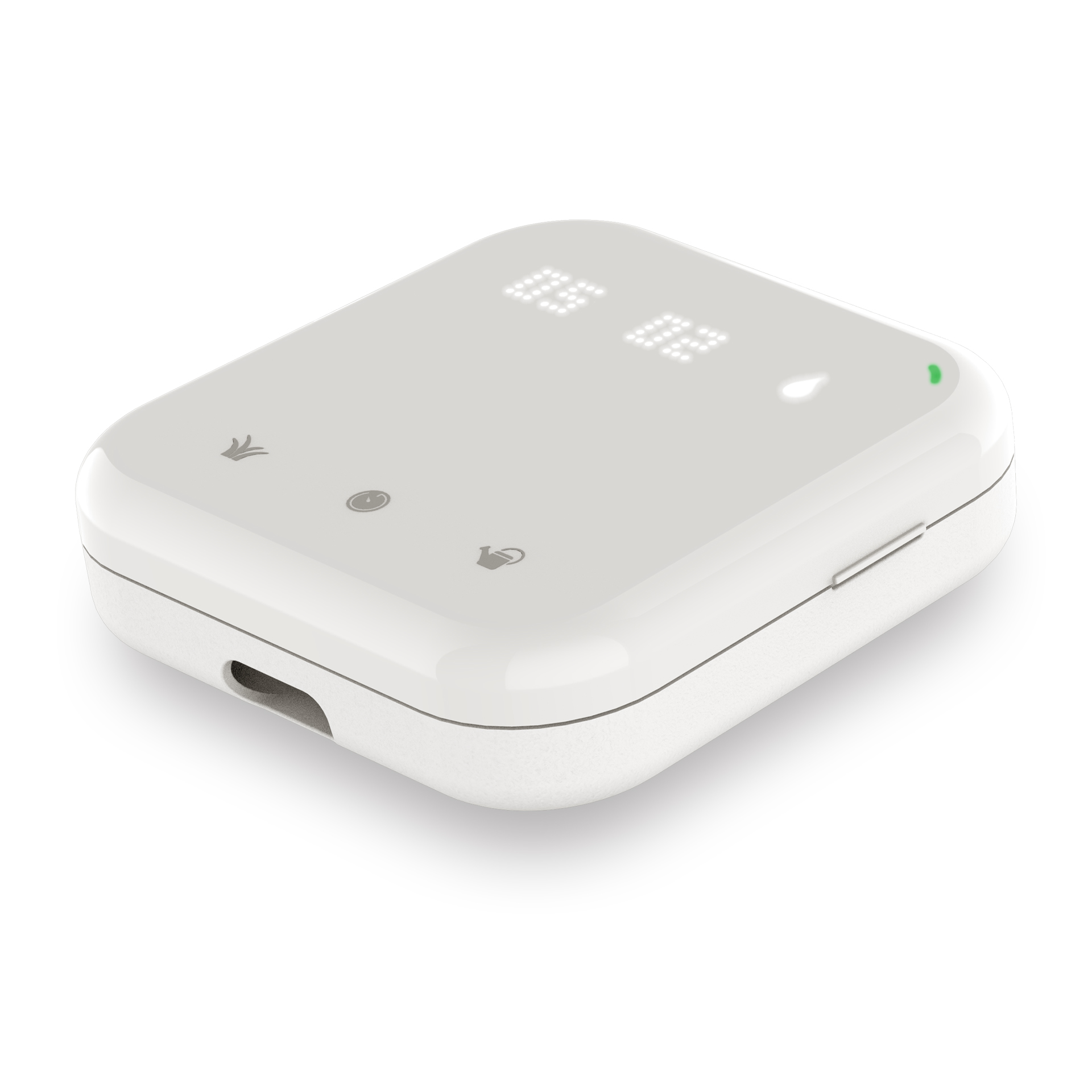

Spark is Netro's new smart watering controller with improvements over the highly rated Sprite in every aspect. It comes with a unique folding design, physical user interface, faster WiFi communication and massive 16-zone capacity. It is enhanced for better local control while retaining all the remote capabilities and smart features.
Touch Control
Now you can start or stop watering through the convenient touch buttons when you are away from your phone or when WiFi is unavailable. Just select the zones, set the minutes and start watering.
LED Display
The backlighting LED matrix shows the active zone and the watering duration. A dedicated colorful LED indicates the connection status and network activities.
