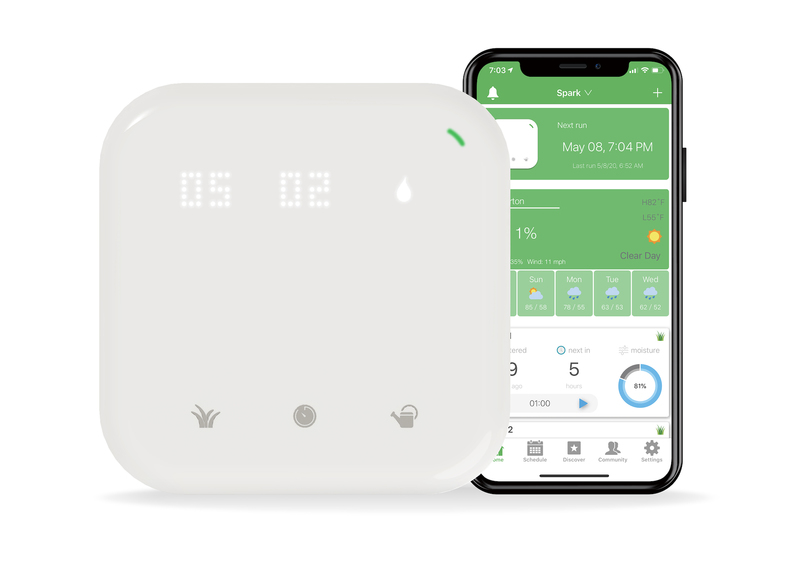

Touch Control
Now you can start or stop watering through the convenient touch buttons when you are away from your phone or when WiFi is unavailable. Just select the zones, set the minutes and start watering.
LED Display
The backlighting LED matrix shows the active zone and the watering duration. A dedicated colorful LED indicates the connection status and network activities.

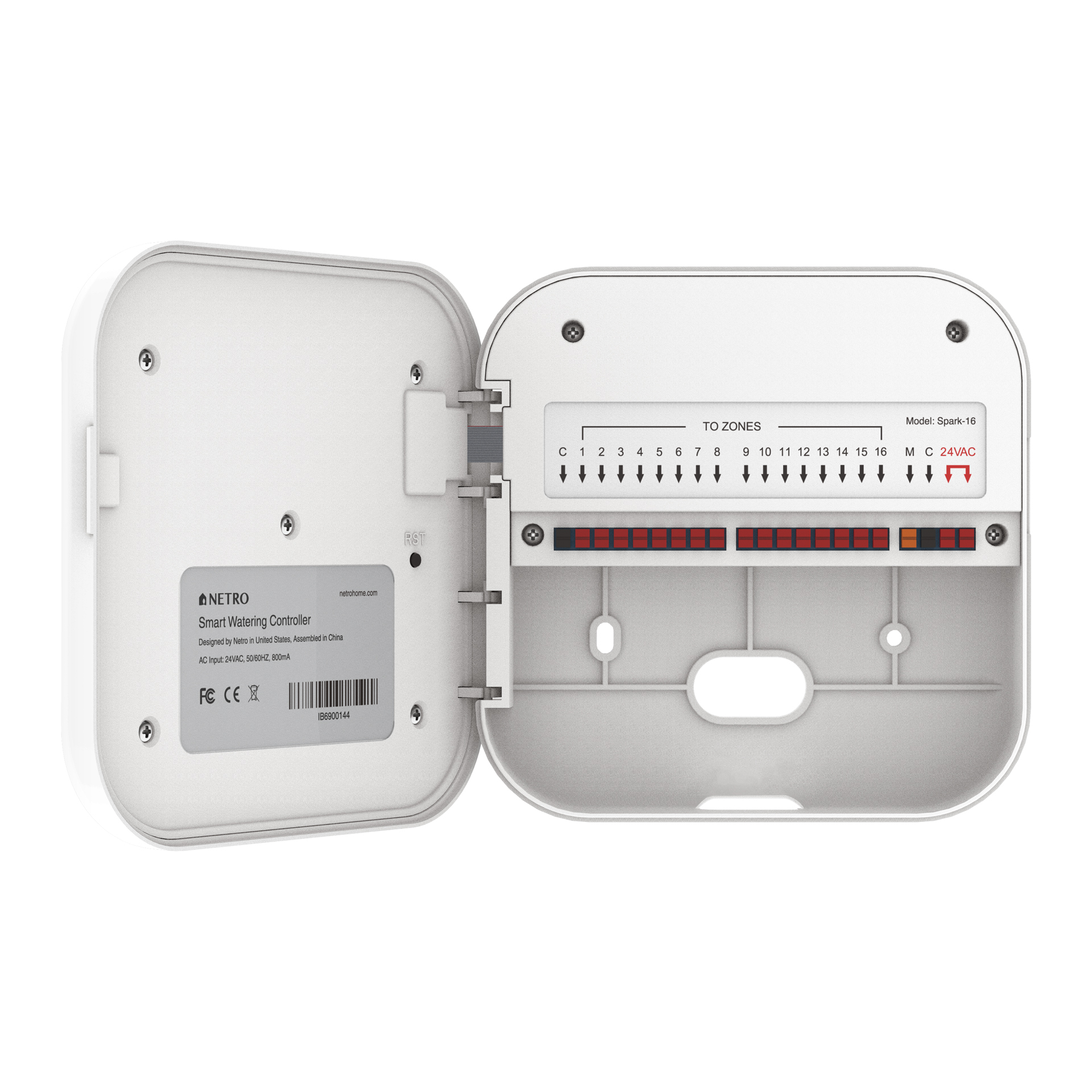

Mechanical Specifications – Dimensions: 5.7 X 5.7 X 1.6 (inches) – Weight: 12.7 oz / 360 g – Output: 16 zones + 1 master valve – Wire size: 18 AWG to 22 AWG – Operating temperature: -4 to 122℉ / -20 to 50℃ – Box contains: smart irrigation controller, AC adapter, wall screws, quick installation guide Electrical Specifications – AC Input: 24VAC, 50/60Hz, 800mA – Valve output: 24VAC, 50 / 60Hz, max 10VA – Master valve: 24VAC, 50 / 60HZ, max 10VA – WiFi: 802.11 N, 2.4Ghz, US Warranty – 2-year limited hardware warranty

The Netro app is capable of managing multiple controllers. You can link two controllers together. You will need to have at least two “common” wires so that each controller gets one. If there is only one “common” wire, it needs to be connected to both controllers by using a wire splitter. It is recommended to only use one power adapter for both controllers. Here is an article to show the connections: https://www.netrohome.com/forum/posts/563
